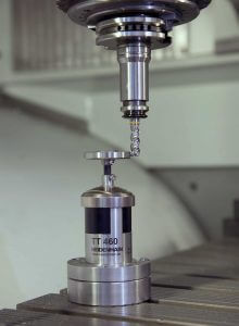

The TT 460 tool touch probe from HEIDENHAIN transmits its signal by radio or infrared from the working space.

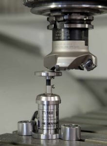

HEIDENHAIN offers two tactile systems for tool measurement: the TT 160 with cable-connected signal transmission and the TT 460 with radio and infrared transmission of the signals. In their current series, both combine more than 25 years of experience in tool touch probe systems. The TT 160 is now the fifth generation of cable-connected tool touch probes on the market. The main advantage of both tool touch probes is their very simple and fast way to measure tools within the process. That saves idle machine time, increases machining accuracy and reduces scrap and rework.
HEIDENHAIN controls permit very comprehensive measurements with very high degree of automation. To measure milling tools, a HEIDENHAIN control rotates the tool counter to the cutting direction and radially approaches the edge of the contact plate. The tool’s diameter is initially measured at the moment it touches and deflects the contact plate. At the same time, the tool touch probe measures the position of the largest tooth. To determine the tooth position more exactly, the spindle is then stopped and rotated step by step from tooth to tooth. The required rotational angle results from the number of teeth saved in the control. After this radial measurement, the length can also be measured with the non-rotating tool.
Thanks to its pluggable cable connection, the TT 160 can also be removed quickly and easily at any time.

The TT 460 tool touch probe is designed for use with a high degree of automation. It is switched on by the control before a measurement and switched off again after the touch probe cycle. It can also be used in 5-axis operation and with pallet changing systems. To keep power consumption as low as possible, when it is not used for a long time the TT 460 switches to a special energy-saving mode even below the actual standby mode. However, if the batteries do lose their charge, any battery with a voltage between 1 V and 4 V can be used. The electronics automatically detect the battery voltage and adapt to it.
