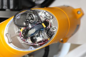

robot arm
On each axis of the robot arm, inductive HEIDENHAIN rotary encoders of type EQI 1100 measure the current position.

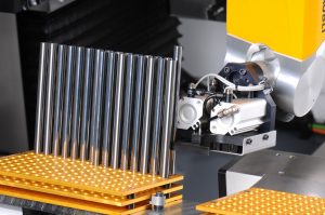

robot arm
To grip a tool on the tightly loaded pallet—in this case for 150 tools with diameters of 10 mm—the robot arm must be moved with high accuracy.
Stäubli uses HEIDENHAIN absolute inductive rotary encoders of type EQI 1100 with 18-bit resolution on the robot for the Strausak machine on the axis drives. One rotary encoder sits on each axis. These supply position data with the necessary accuracy to guide the gripper on the tip of the robot arm so that it can reliably remove the tool from the tightly loaded pallet, insert it precisely into the tool holder and then return it to the pallet after machining. For this purpose, the robot needs to achieve a positioning accuracy of 50 µm at the tip of its gripper.
The absolute position data are an essential factor for success. The machine control, via which not only the grinding sequence but also the robot is controlled, is aware of the precise position of the robot arm in the working space with this data. Homing the robot is to all intents and purposes superfluous and collisions caused by still undetermined positions can be avoided.

Due to their inductive measuring principle, HEIDENHAIN rotary encoders have highly compact dimensions, making them ideal for the extremely tight space conditions in the robot arm. The smallest possible space requirement of the robot arm in the working space was also an important criterion for Strausak when selecting the supplier. “We definitely wanted to integrate the robot arm into the existing, already quite full working space. To achieve that, its kinematics had to enable complete movability within a very tight volume. Another factor was the robot arm in its rest position should not limit access to the working space,” explained Alexandre Condrau concerning the complex requirements.
