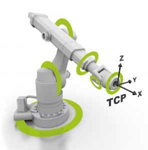

Step 2: secondary encoders for highly accurate position measurement
High-accuracy HEIDENHAIN and AMO encoders for absolute position measurement on robots.
Robotics manufacturers can significantly improve the absolute position accuracy of their robots by using additional, high-accuracy angle encoders or rotary encoders at every robot axis. These so-called secondary encoders, which are mounted after each gear train, capture the actual position of every robot joint. This allows the encoders to account for zero position error and backlash. The retroactive forces on each axis resulting from the machining task are measured as well. All of this results in a 70 to 80 percent improvement of the absolute position accuracy at the tool center point.
Modular angle encoders, such as the HEIDENHAIN ECA 4000 with optical scanning, the HEIDENHAIN ECI 4000 rotary encoder with inductive scanning, and the AMO WMR angle encoder, are well-suited for these applications. Thanks to their modular design with a scale drum or scale tape and a separate scanning unit, these encoders are well suited for large hollow-shaft diameters and for the challenging installation requirements often encountered in robots due to space constraints. The signal quality of these secondary encoders is considerably better than that of the rotary encoders on the servo motor, meaning that the returned position values are significantly more accurate—even for highly dynamic movements.
