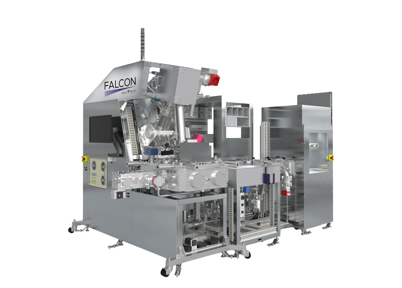

At the center of this collaboration is the HEIDENHAIN LIC 4100V vacuum-compatible encoder, which is integrated in EUV Tech’s FALCON Photoresist Flood Exposure System, specifically within the tool’s antechambers to ensure precise motion control of the sample stage.

EUV Tech FALCON Photoresist Flood Exposure System EUV Tech FALCON Photoresist Flood Exposure System
