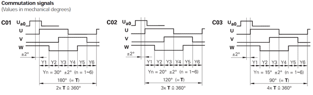

The third commutation method is accomplished with an incremental rotary with what is called block commutation, U, V and W.
These encoders are available with various commutation tracks. Typical versions provide 3- signal periods at 120° mechanical or 4-signal periods at 90° mechanical per revolution. Independent of these signals there are also incremental signals used for position and velocity control.
The block commutation signals are transmitted as square-wave signals at TTL levels.
Figure 4 depicts 3-standard commutation configurations.
Figure 4: 3-standard commutation configurations.
