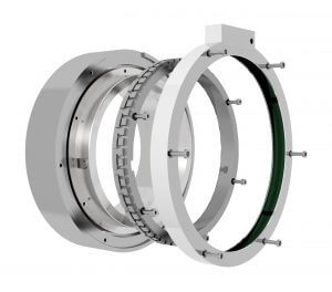

The scale drum (center) of the ECI 4000 is securely connected to the motor mechanics (left) thanks to a keyway (on the right: the scanning unit)

Safe mechanical connection
An example for the safe connection of the measuring device to the drive are the rotary encoders of the ECN 400 and EQN 400 series in functional safety version. They offer a functionally safe hollow shaft connection with mechanical fault exclusion for their blind hollow shafts with diameters of 10 mm or 12 mm. This mechanical fault exclusion avoids faults that cannot be detected by the controller, such slippage of a frictional connection. The other end of the diameter range with shaft diameters up to 512 mm is served by the functional safety versions of the ECA 4000 absolute modular angle encoders.
With these two examples and numerous other solutions for safety-related applications such as the ERM magnetic angle encoders or the LC 415 or LC 495 absolute sealed encoders, HEIDENHAIN covers a wide range of applications in machines and systems. Magnetic angle encoders and inductive rotary encoders are particularly suitable for use in production machines that expose their components to high mechanical loads.

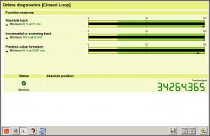

… or for the supported diagnostic functions of an encoder in its functional safety version.
Straightforward and informative: the display of the ATS software, here for example the functional reserve of an encoder …
Various testing and inspection devices are available for the diagnosis and adjustment of HEIDENHAIN position encoders. The inspection device with the broadest application range is the PWM 20. Together with the ATS software, it makes possible the analysis of almost all HEIDENHAIN position encoders with the interfaces listed in the table above. During installation of modular encoders, the PWM 20 uses ATS software to check whether the measuring standard and the scanning unit match each other. If the encoder is connected directly to the PWM 20, a detailed analysis of the encoder functions is possible. If the PWM 20 is looped into the closed loop—if necessary by means of suitable test adapters—a real-time diagnosis of the machine or system is possible during operation. The safety functions can also be triggered and checked via the PWM 20 during initial commissioning or when exchanging encoders for safety-related applications.
