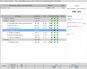

The Batch Process Manager from HEIDENHAIN shows the job status at a single glance, with green check marks for smoothly executing jobs and red X marks for required manual interventions. A time indicator in the upper right of the screen informs the operator about the time of the next intervention.

Always in the right place at the right time: the Batch Process Manager from HEIDENHAIN ensures that the right workpiece and all of the tools and information required for machining are available in the machine and on the control.
After the creation of a job list, the control automatically determines whether all of the prerequisites for smooth execution of the entered jobs are fulfilled. This process includes a check of the following criteria:
  • Is a preset defined at the level of the pallet, program or fixture?
  • Are the required tools available in the tool magazine, and do they have sufficient tool life?
  • Does the NC program run in simulation mode without error messages?
The Batch Process Manager displays the results of this analysis in a clear and straightforward graphical overview. The user immediately sees whether all of the programs will run without error and whether all of the required tools are available. He can also see how long his job list will take to complete. The Batch Process Manager repeats this analysis cyclically so that the displayed data are continually updated.
If the control detects a problem, such as a tool with insufficient service life for the planned machining operation, then the Batch Process Manager displays the anticipated time at which the manual intervention will be required. The Batch Process Manager provides the following information in advance:
  • The machining sequence
  • The time of the next manual intervention
  • The program duration and run time
  • Status information regarding the preset, tool, and NC program
A prerequisite for all analyses involving tools is the enabling of option 93, Extended Tool Management, on the control. The NC program is executed as usual over the pallet management function. Naturally, the Batch Process Manager can be used for planning even when individual NC programs are executed in the Program Run, Full Sequence operating mode. In this case, the pallet entries must be manually locked after machining.
batch process manager
Job sequence planning made easy: the Batch Process Manager for the HEIDENHAIN TNC 640 organizes the sequence in which jobs are machined and provides a preview of the expected results.
