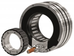

Direct Drive Motor
ETEL’s line of TMB+ direct drive motors range from 160mm (6.3 in) to 1288mm (4.2 ft).
2. More size options
Direct drive motors are key components used in the machine tool both from a performance and product quality point of view because they need to provide the optimum power within a certain volume. Increasing geometrical variation in motor design is providing machine builders more flexibility to fit the optimum motor for a particular application in the space available while still minimizing the footprint.
For torque motors, you have the variables of diameter, length and power. But it’s not as challenging as it once was to find the ideal mix. For example, if the outer diameter of a motor is limited, then there are often many height options available to the machine manufacturer that still maximize torque.
The variety of sizes available also offers cost flexibility. For example, the ability to increase the length of a linear motor can reduce width and, in turn, the amount of costly magnet material along the length of travel. Having a large variety of sizes allows a machine maker to more easily maximize the space and efficiency of the machine, so much so that it may start to feel like the motors are made just for the machine and not the other way around.

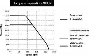

An example of a Torque vs. Speed Graph for a direct drive motor. Changing the windings moved the diagonal line across the X-axis.

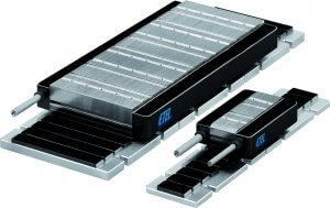

For linear motors one way to simplify integration is to keep the magnetic way consistent. Things become very complex when, for instance, a builder works with different sizes of linear motors across their machine and the linear motor tracks don’t have a consistent bolt hole pattern or width increments. This becomes especially complicated if an engineer wants to upgrade the motor and she has two parts she needs to adjust. If a similar magnetic way track can be used across multiple motor models, as is possible with ETEL’s magnetic way-compatible LMG and LMS motors, it allows for easier adjustments as the motor changes. The benefit is even greater if a next-generation model can still use the original tracks, as it allows the customer to upgrade their machine with minimal effort.
4. More winding options
Although a motor may have a torque or force (e.g. continuous and peak values), it may still be limited by how much of that value is available at different speeds. Due to back-EMF voltage, Eddy currents and other factors, the greater the speed a motor runs, the lower its torque capabilities become. A common way of reducing these effects is by adjusting the winding of the copper coils to raise the speed threshold at the cost of requiring more current. This is an aspect that can be adjusted with minimal impact on the motor’s torque/force capabilities. Most motors have at least two options, but there is the possibility of having up to four, as with ETEL’s size range offering, which allows more flexibility in terms of what can be done within a fixed motor size. The idea is to propose several torque vs. speed profiles within each motor footprint in order to satisfy as many operating ranges as possible.

ETEL has developed unique applications for their direct drive linear motors, such as a curved linear motor track solution which will be released in 2019.
5. New ways of integrating
Direct drive motors have had their standard applications for a while, but as machine makers have gotten more familiar with the technology, they’ve come up with ways to take advantage of direct drive. One example of this in the traditional configuration of a linear motor, moving along a magnet track, is having the magnet piece move rather than the motor. This configuration is used to get either short, quick strokes with the magnetic way or have a single magnetic piece move across a track of linear motors. This allows a payload that is not only lighter, but also not attached to a cable, allowing freer reign when it moves.
One can also take a linear motor and adjust the magnetic way to move on a curve rather than a straight line for moving a payload in either a circle or “stadium configuration.” This not only takes up less space than a torque motor, but it’s also a more economical solution since users can avoid paying for a large torque motor with unnecessarily high torque capabilities. Combine that with the modularity of a separate linear motor that can be used in parallel, and it’s also a solution that’s easy to integrate and maintain.
