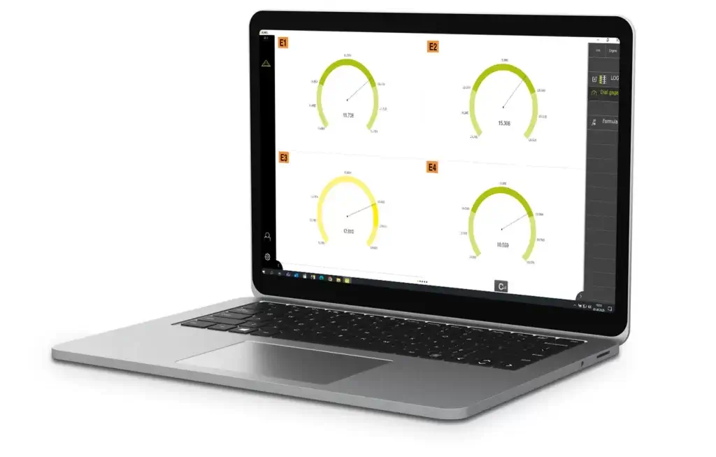

  • Intuitive user interface with configurable function elements
  • Configurable axis naming
  • Graphical dial gage for measurement display
  • Measurement series with min. and max. value recording
  • LOG function directly in Excel
Easy evaluations
With its Dial Gage function, the GAGE-CHEK 4000 SW lets you directly compare measurements with nominal values, warning limits and tolerance limits. The measurements are shown in a colorful graphical dial gage that supports you during evaluation.
Configurable function elements
Work efficiently with the GAGE-CHEK 4000 SW by configuring the functions in the side area of the screen, adapting them to the specific requirements of the measuring task. Other functions are available as well, such as a preset table and minimum and maximum value recording.
Measuring with reference parts
The mastering function lets you apply the values of a reference part for the given axis, as well as save metadata. During measurement of the reference part, you can apply the values individually or collectively in the digital readout.
