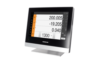

POSITIP 8000 series
- Digital readouts for fast and reliable positioning
- 12-inch touchscreen with intuitive user interface (1280 x 800 pixels)
- Up to three NC-controlled axes and switching functions for simple automated tasks
- Up to six axes (1 VPP, 11 µAPP, EnDat 2.2)
