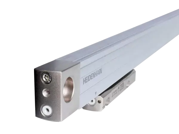

The narrow extrusion of an LC 400 enclosed linear encoder with a compact readhead.
