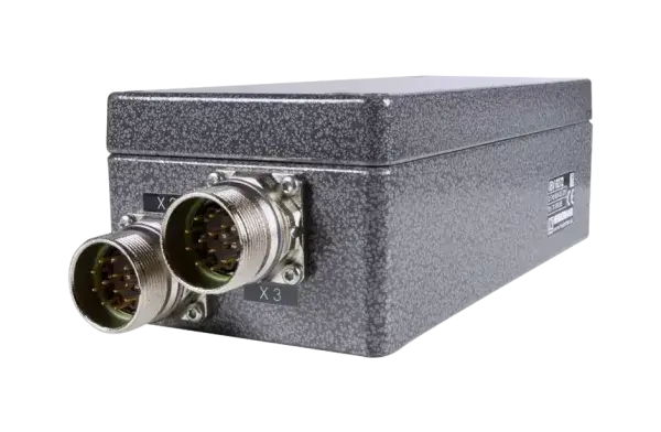

IBV 6000 series
Signal converters with incremental input interface and multiple output configurations
- Input: 1 VPP
- Two configurable outputs with 1 VPP and/or TTL signals, as well as configurable interpolation factors
Configurable outputs
Rewiring the two output flange sockets allows configuration of 1 VPP or TTL signals with different, settable interpolation factors.
Built for long-term operation
Thanks to its dust-proof and water-resistant design with an IP65 rating, the IBV 6000 interpolation and digitizing electronics can handle harsh daily shopfloor conditions.
