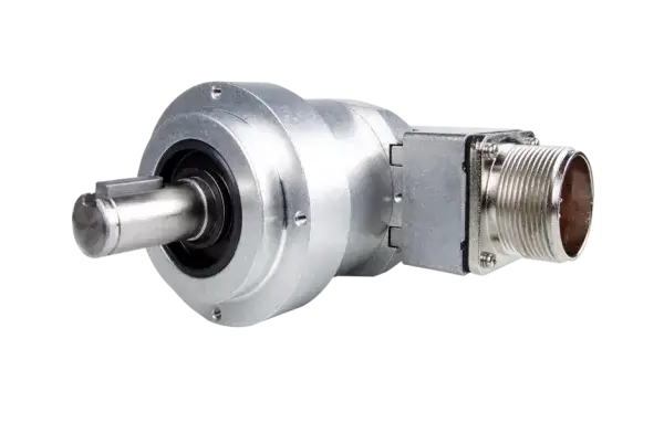

ROD 600
Incremental rotary encoders with integral bearing
- Solid shaft for separate shaft coupling
- Positioning accuracy of down to ±13″
- Up to 5000 signal periods per revolution
- Max. operating temperature: 85 °C
- Protection rating: IP66
- Interfaces: HTL and TTL
- Housing diameter ≈ 66 mm
Precise positioning
Rotary encoders with a bearing and stator coupling ensure consistently high accuracy. Thanks to optimally matched components, system accuracies of down to ±13 arc seconds are attained.
Compensatory rotor coupling
A separate rotor coupling is used to couple the rotary encoder. This coupling compensates for axial movements, radial misalignment, and angular offset, thereby preventing loads on the rotary encoder’s bearing and a reduction in service life.
Proven technology
The ROD 600 rotary encoders feature high reliability and perfected technology with a robust design. For decades, these encoders have proven themselves in great numbers within machine tools.
Connection flexibility
The cable can be connected either axially or radially. A special swivel mechanism in the encoder’s housing allows the flange socket to be easily rotated in the desired direction. As a result, the cable outlet is always exactly where it should be.
