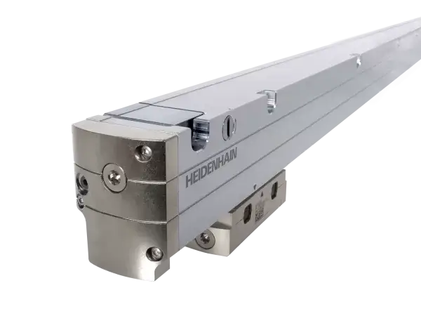

The readhead and scale housing of an LC 200 linear encoder with a side access cover on the end section for scale-tape tensioning.

Multiple housing sections can be joined together to form long measuring lengths. A steel scale tape is drawn through them and secured to the machine bed at both ends of the encoder. Due to the design, scanning is performed with the housing at a neutral range of tilt, thus preventing inaccuracy at the section joints.
