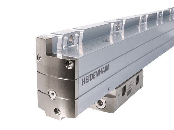

Absolute linear encoders with full-size scale housing
  • For highly dynamic linear axes up to 4240 mm long
  • Rugged and vibration-tolerant design
  • Highly reliable and accurate position measurement
  • Proven industry benchmark for encoders in machine tools
  • Available with functional safety
  • Interfaces: EnDat, Fanuc, Mitsubishi, Panasonic, and DRIVE-CLiQ
  • Sustainability with TRUE IMAGE TECHNOLOGY
High vibration tolerance
The full-size LC 100 linear encoders feature long measuring lengths, high ruggedness, and superb vibration tolerance, allowing them to thrive in harsh environments.
Functional safety
LC 100 linear encoders are available with functional safety and fault exclusion for the mechanical connection. When integrated into a system, this solution for applications with up to SIL 2 can minimize malfunctions and enable safe machine tool operation.
Consistent accuracy
The LC linear encoders deliver consistently high accuracy. A high-quality, very low-wear ceramic coupling prevents wear-induced inaccuracy throughout the service life of the encoder.
Reliable protection
An efficient seal design with double lips provides optimal protection from chips, dust, and coolant. Due to the diagonal orientation of the sealing lips and the scanning unit’s sword, the encoder can be mounted either upright or on its side.
Sustainable and reliable processes through TRUE IMAGE TECHNOLOGY
Thanks to innovative TRUE IMAGE TECHNOLOGY, the HEIDENHAIN LC 106, LC 201 and LC 406 linear encoders deliver accurate scale readings without the help of purge air, ensuring reliable position feedback even when exposed to condensation and other liquid contamination.
