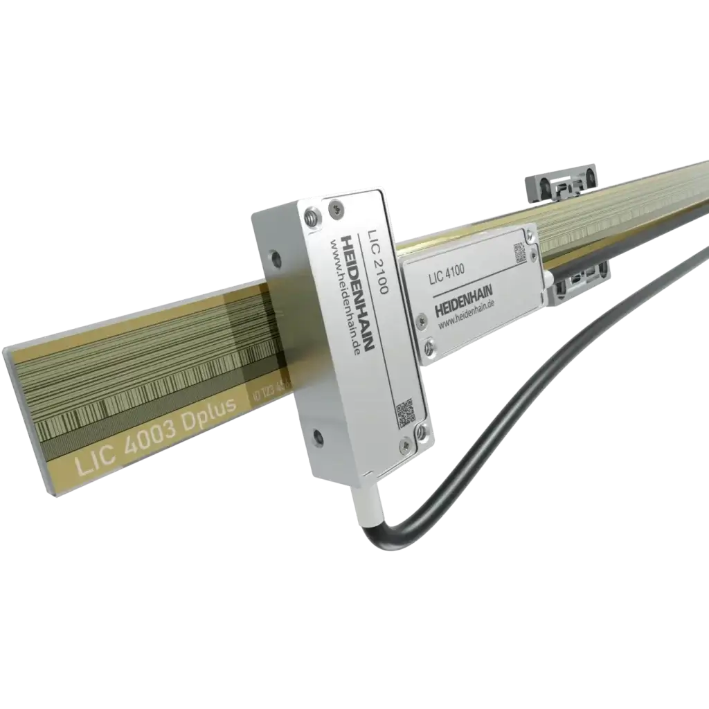

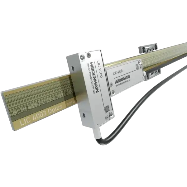

LIC 4100 Dplus series
Absolute linear encoder with graduation tracks at 0° and 90°
- For high-accuracy, fast-travel linear axes
- Main measuring length: up to 3040 mm
- Secondary measuring length: ±0.5 mm
- Variant with a very small measuring step down to 1 nm
- High speed and position stability
- Standard scanning heads from the LIC 4100 and LIC 2100 encoders
- Interfaces: EnDat, Fanuc, Mitsubishi, Panasonic, and Yaskawa
