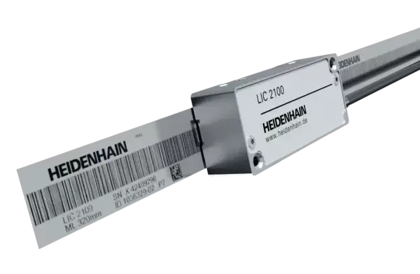

LIC 2100 series
Absolute linear encoder for simple applications
  • For linear axes with high traversing speeds
  • Measuring lengths of up to 3020 mm
  • Various mounting options
  • Resistant to contamination
  • Interfaces: EnDat, Fanuc, Mitsubishi, Panasonic, and Yaskawa
An LIC 2100 open linear encoder with a HEIENHAIN readhead and a steel tape scale with an absolute track.
Thanks to a large scanning field, the encoders of this series are highly resistant to contamination. Localized impurities on the measuring standard have minimal effect on the signal quality and measurement reliability.
Easy installation
The wide mounting tolerances of the exposed linear encoders from HEIDENHAIN have only a minimal effect on the output signals, thus enabling fast and easy mounting. The mounting area on the machine requires only a simple mechanical design.
High traversing speeds
Along with high accuracy, the LIC 2100 linear encoders permit very fast traversing speeds of up to 600 m/min. Position measurement is absolute and, thanks to high contamination resistance, very reliable.
