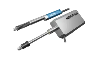

METRO series
- Incremental length gauges
- System accuracy: ±1 µm / ±0.5 µm / ±0.2 µm
- Measuring range of up to 100 mm
- High repeatability
- Version with low measuring forces

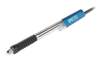

SPECTO series
- Measuring range of up to 30 mm
- Dust-proof and protected from splash water
- Highly compact design
