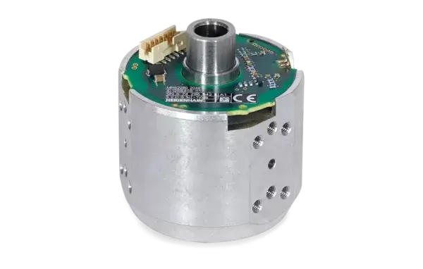

MRS 2200 series
Incremental angle encoder modules with integral bearing for rotary and tilting axes
- System accuracy: ±10”
- Signal periods: 2048
- Hollow through shaft diameter: 10 mm
- High repeatability and tilting rigidity
- Direct loading
- Up to 60% fewer components in the application
- Interface: 1 VPP
High repeatability
Achieve exceptional measurement quality through low measurement variation: these modules combine a high-accuracy angle encoder and a tilt-resistant bearing for exceptional repeatability even under off-center loads.
Easy installation
Thanks to a pre-loaded bearing and pre-mounted angle encoder, these modules eliminate the need for exact alignment and adjustment in the application. Installation is even easier if the mounting component includes a centering collar.
