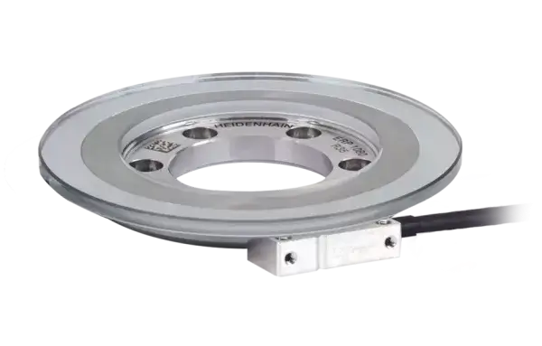

An ERP 1000 angle encoder with a glass disc scale assembled to a metal hub and being scanned on one side by a readhead.
