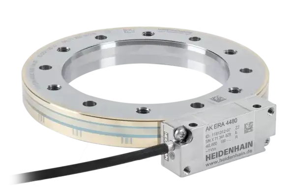

ERA 4000 series
Incremental optical angle encoders with optimized scanning
- Very high accuracy and excellent signal quality
- Steel scale drum with three-point centering or centering collar
- Graduation accuracy: ±1.7” to ±5”
- Signal periods: 3000 to 52,000
- Diameters: 76 mm to 560 mm
- Interface: 1 VPP
Reliable scanning
The ERA 4000 series angle encoders feature very high scanning reliability thanks to large scanning fields and special signal processing. This, along with their robust graduation and wide mounting and operating tolerances make for a dependable complete system.
Universally deployable
Universal usage is possible thanks to a wide range of drum diameters, drum geometries, graduation accuracies, and interfaces. Applications include highly accurate rotary axes in machine tools, fast rotating spindles, and highly accurate applications in the metrology and electronics industries.
Application-oriented design
This massive drum structure prevents any loss of accuracy during mounting. The three-point centering method makes mounting quick and easy.
The angle encoders of the ERA 4000 series feature an LED that shows the accuracy of the mounting as well as provides information on the encoders operational status.
