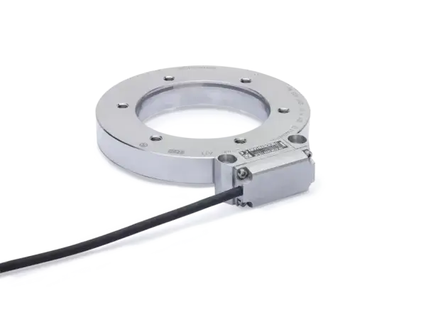

An ECM 2400 angle encoder with a steel ring scale being scanned on its outer rim by a readhead with two mounting holes.
