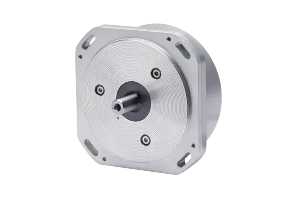

ROC 2000 series
Absolute angle encoders for separate shaft coupling
  • System accuracy of ±5”
  • Solid shaft with ∅ 10 mm
  • Position values per revolution: 26 bits
  • Interfaces: EnDat 2.2, Fanuc Serial Interface αi, Mitsubishi high speed interface
An ROC 2000 angle encoder with a cylindrical housing, a quadratic mounting flange, and a solid shaft.
High permissible shaft speeds
The solid shaft of the ROC 2000 series angle encoders is connected to the measured shaft via a separate coupling, thus enabling shaft speeds of up to 3000 rpm in conjunction with a purely serial interface.
High accuracy
These angle encoders feature a high line count of 16,384 and excellent signal quality. The benefits are a high 28‑bit resolution and smooth motor operating behavior.
