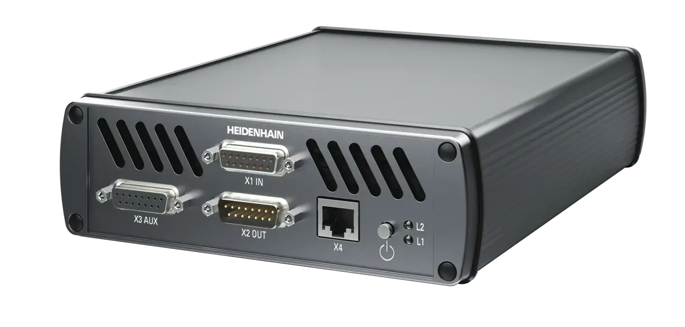

Inspection unit for checking and adjusting absolute and incremental HEIDENHAIN encoders
  • Functional testing
  • Mounting wizard
  • Ability to be calibrated
  • Adjustment via ATS software
  • Online diagnostics with the EnDat interface
  • Ethernet port for connectivity with a PC
PWM 3000, Inspection unit for checking and adjusting absolute and incremental HEIDENHAIN encoders
Diagnostics directly on the encoder
Featuring flexibility and high bandwidth at its measuring input, the inspection unit can be connected directly to a wide variety of HEIDENHAIN encoders for detailed functional analysis.
ATS adjusting and testing software
The ATS software features automatic encoder detection through a local encoder database. High performance and a continually growing range of functions ensure future-readiness.
Diagnostics within the control loop
The unit is inserted within the closed control loop for real-time, on-machine inspection of the encoder during operation. High EMC robustness is made possible by the unit’s Ethernet port.
