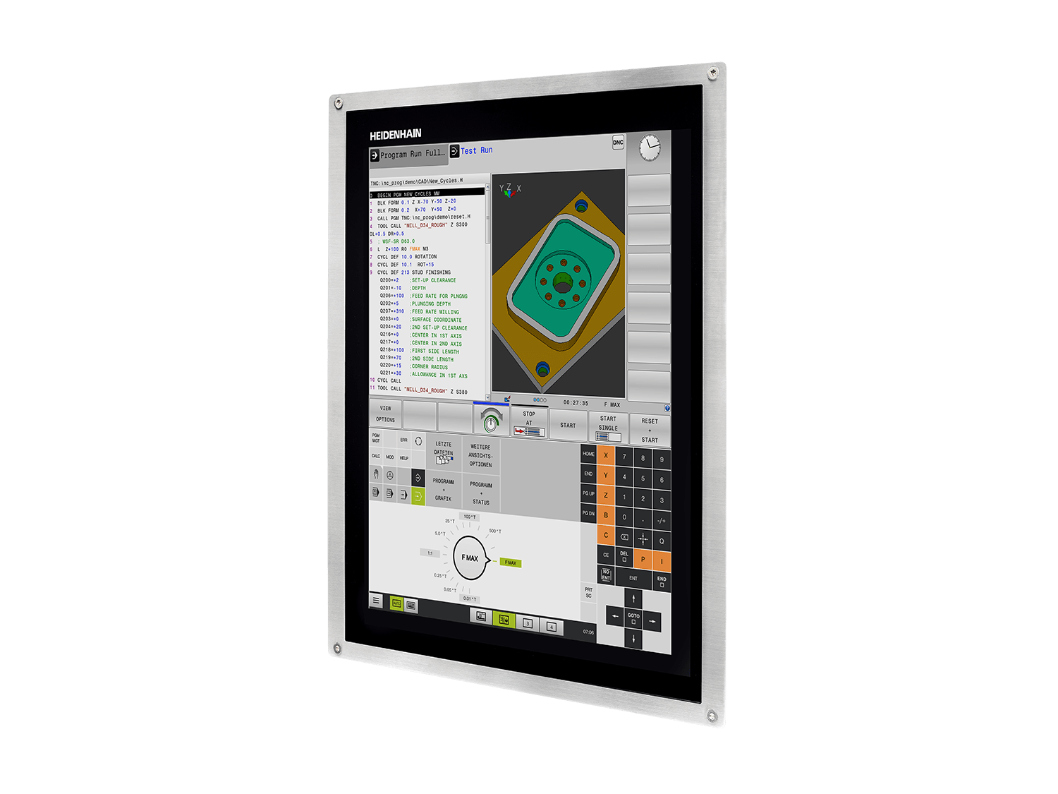

Screen view
The intuitive and clearly structured user interface make simple operation and optimal orientation possible
Multitouch operation
Gesture control makes it very easy to zoom and rotate simulation graphics as well as to navigate through programs, tables, or menus
