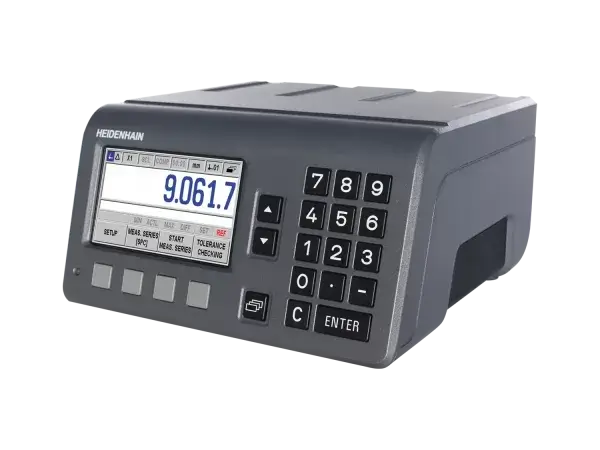

ND 200 series
Readout for measuring and positioning tasks with up to two axes
- Easy operation and user guidance
- Recording and evaluation of measurement series
- Statistical Process Control (SPC)
- Graphical evaluations
- Switching functions for simple automated tasks
Standardized data interfaces
The ND 200 digital readouts are equipped with serial interfaces (USB and V.24/RS-232-C) for transmitting measurements to a PC, inputting and outputting parameters and compensation value lists, and running diagnostics.
Convenient part sorting
The sorting function allows workpieces to be checked for dimensional accuracy and classified. For automation solutions, you can further process these classification signals through integrated switching outputs.
Fail-safe memory
To prevent losing data during a power failure, up to 1000 measured values are stored in the nonvolatile FIFO memory for Statistical Process Control (SPC).
Statistical evaluations
The ND 200 series digital readouts let you save multiple measurement series and display maximum, minimum, or difference values for review. These values can be checked for tolerance compliance via sorting functions.
Application-oriented design
Display of position values, dialog boxes, input fields, graphing functions, and soft keys
Connection with automatic interface detection of all incremental encoders with 11 µApp and 1 Vpp as well as absolute encoders with the EnDat 2.2 interface from HEIDENHAIN
The robust aluminum enclosure and splash-proof full-travel keyboard make the ND 200 suitable for the workshop
