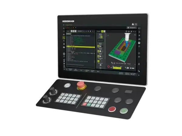

TNC7 go straight-cut control
Intuitive, task-focused, and customizable
  • Up to 6 control loops for machine-design flexibility
  • 16-inch Full HD touchscreen
  • Smooth and intuitive multi-touch operation
  • Graphical positioning through touchscreen gestures
  • Customizable user interface
  • Manual machining cycles for fast results without NC programming
  • Fast responsiveness

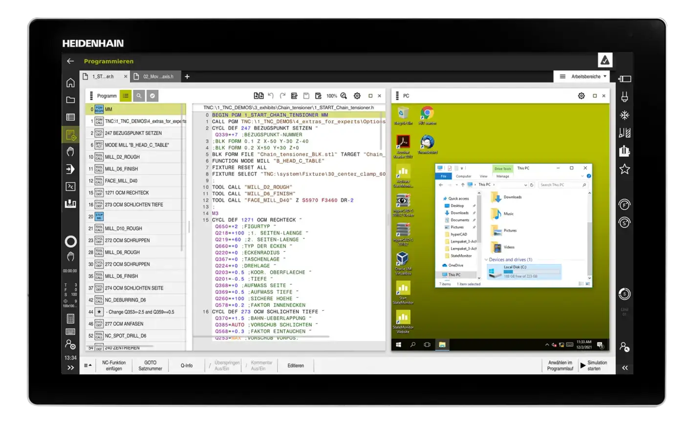

    Intuitive user interface
    The user interface of the TNC7 go ensures a gentle introduction to CNC machining thanks to state-of-the-art multi-touch interactions and an intuitive screen layout.

    Remotely operate external PCs
    Remote Desktop Manager brings your office PC straight to the screen of your TNC control. While standing at the machine, you can access PDF files, ERP software, office applications, technical drawings, and emails. Applications requiring substantial processing power continue to run on your office PC and do not affect your CNC machining.
