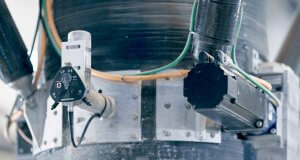

The control wasn’t the only component replaced during the retrofit; the retrofit team from the HEIDENHAIN agency TEDI also replaced the four motors that move the portal, as well as the way in which the motors act on the gear rack—a design developed by Tamsen Maritim itself.
A third bearing was also installed for each carriage, thus ensuring considerably smoother motion and permitting adjustment of the contact pressure between the drive belt and the gear rack, as well as allowing the individual motors to be mutually tensioned. “The belt is now in better contact with the gear rack, resulting in less play,” says Wicklein, explaining the reason for the measures. “Even though the accuracy requirements in shipbuilding and large-part construction are not the highest, our post-retrofit goal was a machine accuracy of 0.3 mm to 0.4 mm over a machining length of 80 m.”
