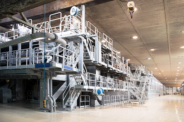

In a current example from a modern kraft paper industrial application, ABB was able to start on the basis of the customer’s existing motors and need for a safety solution. Using new transformers, frequency converters, safety systems and control systems, it was possible to meet the customer’s requirements for both production capacity and increased staff safety.
Leine & Linde’s FSI 862 encoder is part of the drive system in that it provides reliable feedback on speed to ABB’s ACS 880 frequency converter. This is possible as the encoders are certified to safety level SIL2/PLd and communicate well with ABB’s built-in safety functionality. The encoders also have a safe and non-slip mechanical installation, with a guide pin or a key and keyway.
