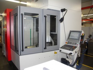

![](https://www.heidenhain.us/wp-content/uploads/2010/12/iTNC_530_Exeron_HSC_600-hi-300x225-1.jpg)
Glance into the machine room: precise HSC milling

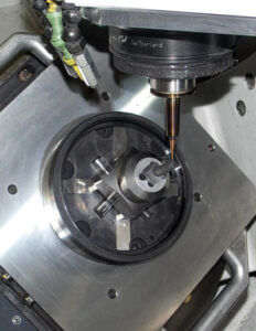

![](https://www.heidenhain.us/wp-content/uploads/2010/12/Form_2639_Kst-Teil-hi-300x225-1.jpg)
This injection molding die is used
to manufacture a valve body
of PFA (Teflon).
