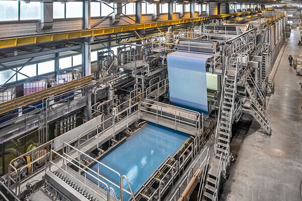

AHLSTROM-MUNKSJÖ PAPER in Aalen, Germany, is a paper manufacturer with traditions dating back more than 400 years. They make décor paper, a specialty paper used for decorative prints. This paper provides a beautiful surface for pressed wood products, furniture and flooring. The mill has received several awards for its efficiency, despite the fact that machines and components are put under a high level of stress due to the harsh production conditions inherent with producing décor paper. Leine&Linde’s encoders in the 800 series, with ADS Online, are used at the plant.
