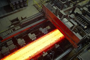

A steel mill’s rolling stands operate in one of the industry’s absolute toughest environments, with high temperatures, aggressive chemicals, shock impact and vibrations. But thanks to its robust construction, the new Linear 4000 series can stand up against the demanding environmental conditions inherent in this application, without the need for being mounted inside a cylinder of the operating machine. These new linear encoders come with an encapsulation which enable them to withstand heat and other strong external stresses, while their absolute inductive scanning resists the hard impact and strong vibrations. To reduce the running costs Leine Linde has created a system that doesn’t need compressed air to prevent the system against dust.
