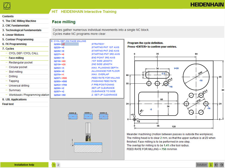

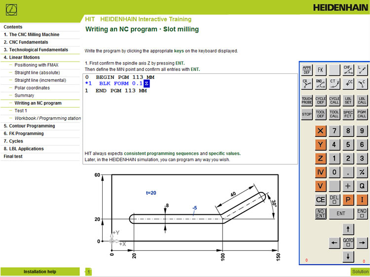

Operation of the HIT software is intuitive, so that you quickly and easily find your way through the training environment. The contents are divided into defined learning sequences, which are clearly and understandably organized. There are interactive tests for each topic in order to check and improve your knowledge after each learning sequence.

HIT first imparts the fundamentals of CNC machines, in order to establish important knowledge required for the creation of NC programs. Next comes the programming of linear paths, followed by training units covering the programming of contours. Once this knowledge is attained you can learn how cycles are used to very easily realize frequently repeated workpiece operations. Finally, HIT teaches you how elaborate programs can be structured more efficiently with subroutines and program section repeats.
