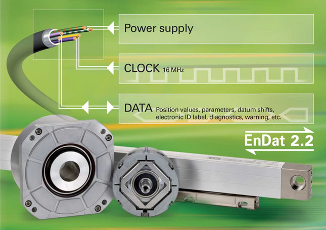

EnDat 2.2 – Bidirectional Interface for Position Encoders
Digital drive systems and feedback loops with position encoders for measured value acquisition require fast data transfer with high transmission reliability from the encoders. Further data, such as drive-specific parameters, compensation tables, etc. must also be made available. For high system reliability, the encoders must be integrated in routines for error detection and have diagnostic capabilities.
The EnDat interface from HEIDENHAIN is a digital, bidirectional interface for encoders. It is capable both of transmitting position values from incremental and absolute encoders as well as transmitting or updating information stored in the encoder, or saving new information. Thanks to the serial transmission method, only four signal lines are required. The data are transmitted in synchronism with the clock signal from the subsequent electronics. The type of transmission (position values, parameters, diagnostics, etc.) is selected through mode commands that the subsequent electronics send to the encoder. The EnDat 2.2 interface, a purely serial interface, is also suited for safety-related applications.

The extended EnDat interface version 2.2 is compatible in its communication, command set and time conditions with the previous version 2.1, but also offers significant advantages. It makes it possible, for example, to transfer what is termed "additional data" with the position value without sending a separate request for it. The interface protocol was expanded and the time conditions were optimized as follows:
• Increased clock frequency (CLOCK) (16 MHz)
• Optimized calculating time (position value acquisition within 5 μs)
• Minimized dead time (recovery time)
(1.25 to 3.75 μs)
• Expanded power supply range
(UP = 3.6
to 5.25 V or 3.6 to 14 V at encoder)
