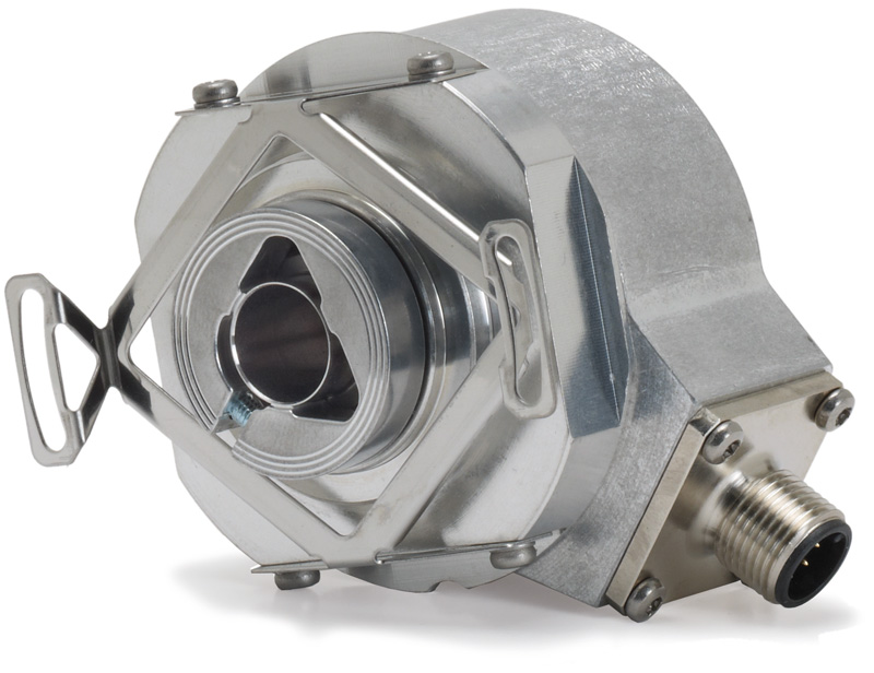

Of HEIDENHAIN's 400 series, the ECN/EQN 400 rotary encoders with stator couplings are available with a blind-hollow or hollow through-shaft.  The stator coupling compensates radial runout and alignment errors without significantly reducing the accuracy. The encoder shaft is directly connected with the shaft to be measured. During angular acceleration of the shaft, the stator coupling must absorb only that torque caused by friction in the bearing.

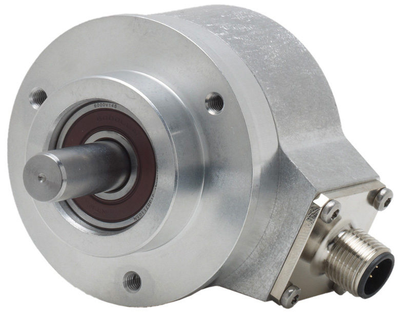

The ROC/ROQ 400F rotary encoders with separate shaft coupling are available with a synchro flange or clamping flange, and have integral bearings and a solid shaft. The shaft coupling compensates axial motion and misalignment (radial and angular offset) between the encoder shaft and measured shaft. This relieves the encoder bearing of additional external loads that would otherwise shorten its service life. Diaphragm and metal bellows couplings designed to connect the rotor of the ROC/ROQ 400F encoders are available.
