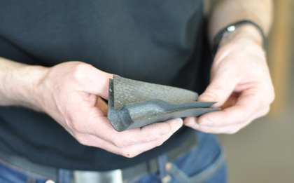

Delicate workpieces made from carbon fiber and reinforced plastics for motorsports.

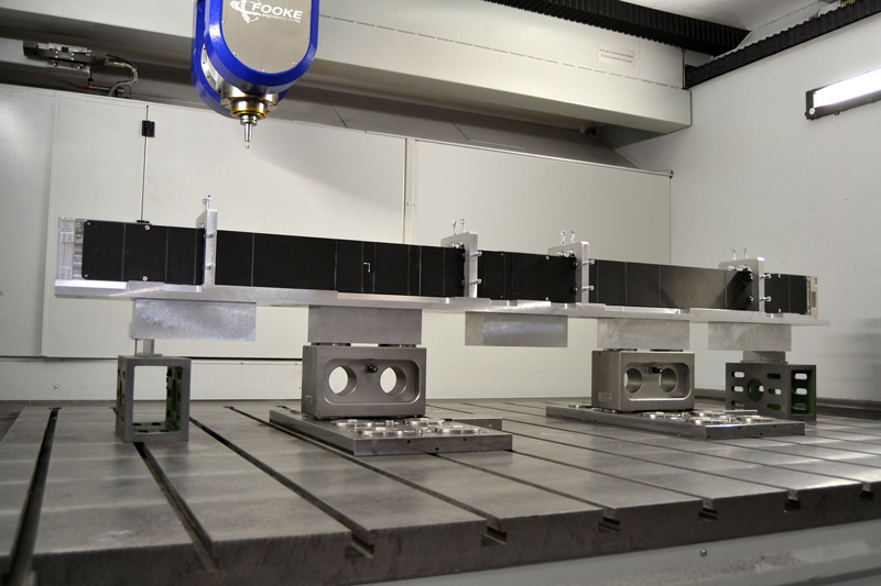

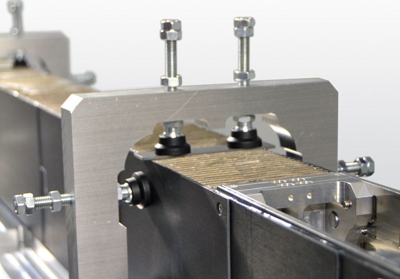

Carbomill also doesn't want to lose any time when setting up workpieces, so an integrated fixture system is used for most operations. Whenever possible, the necessary studs remain on the workpiece, in order to perform later machining steps very quickly and accurately. This saves a large amount of time during serial production, since setting up the next workpiece then only takes a couple of minutes.

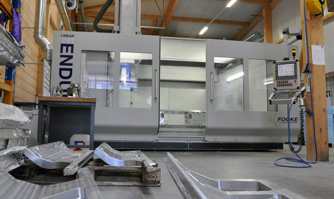

The Fooke ENDURA 711 fills the startup's hall.

The integrated fixture system dramatically reduces idle machine times.
