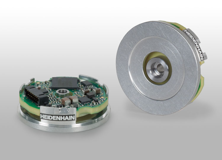

Figure 1- EBI 1135
Battery-Backed Multiturn Rotary Encoder
for Innovative Servo Motors

"The EBI1135 encoders are the first generation of inductive multiturn rotary encoders from HEIDENHAIN with battery buffering," explained Dr.-Ing. André Schramm from Marketing and Product Management at HEIDENHAIN. "Thus, compared with our other multiturn rotary encoders, all with mechanical transmission, we can achieve comparably high degrees of control and precision with the battery-buffered devices despite their small size, which means that a high level of control performance can also be achieved."

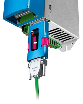

Figure 3- Absolute Encoder Support
"It is just a pity," added Heinz Bäzner with a laugh, "that we did not come across the encoder before we had finished the design phase. Otherwise we could have made the motor another 10 mm shorter." The number of revolutions is generated inductively with this new generation of encoders and buffered with the battery. This means that even if there is a power failure, the current position of the servo motor can always be read out. Here, the battery is mounted externally, as with all encoders with battery buffering, because the temperatures are too high where the encoder is incorporated in the motor. At STÖBER, the battery is mounted in the likewise newly developed Absolute Encoder Support (AES). The AES is installed between the servo controller and the rotary encoder cable. The advantages of this solution are that the battery is easy to access and the absolute position of the servo motor is safely buffered even when the servo controller is replaced.
Small rotary encoder with extraordinary performance data
The EBI 1135 absolute multiturn encoder attains a total resolution of 34 bits (singleturn: 18 bits, multiturn: 16 bits). Thanks to its modular design without ball bearings and transmission, it is one of the world's smallest absolute rotary encoders with a length of 12.3 mm and outside housing diameter of only 36.83 mm. It is therefore predestined for use in highly dynamic servo motors of small size for automation technology and industrial robots.
The new rotary encoder with battery-buffered revolution counter distinguishes itself in particular with optimized inductive scanning evenly around the circumference together with a sturdy design. This produces a high degree of precision of ± 120", good controller quality and a large permissible axial mounting tolerance of ± 0.3 mm. The large permissible axial mounting tolerance of ± 0.3 mm, the wide voltage range of 3.6 to 14 V and, compared with multiturn scanning with a mechanical transmission, the greatly expanded multiturn value range of 65,536 distinguishable revolutions increases the reserves in the application available to the customer. The electronic multiturn scanning without additional mechanical components also improves the shock and vibration compatibility and ensures low-noise operation.
According to Dr. André Schramm, "The EBI 1135 is the first inductive encoder that is equipped with the EnDat 2.2 interface." This purely serial interface permits fast and secure data transmission at clock-pulse rates of up to 8 MHz for high drive dynamics even in environments with potentially high electromagnetic interference (e.g. welding robots). In addition, the greater voltage range of 3.6 V to 14 V means that there are no longer any problems with voltage drop in the cable.
The multiturn function of the EBI 1135 is realized through a revolution counter. To prevent loss of the absolute position information during power failure, the multiturn must be driven with an external buffer battery. Compared with the absolute value encoders with battery-buffered revolution counter currently in widespread use in Asia, two features of the EBI 1135 are to be highlighted in particular. One the one hand, the power consumption in battery-buffering mode was lowered to 12 µA (the usual value here is about 25 µA) and a longer battery life of approximately 10 years could be achieved using a buffer battery with 1500 mAh and 3.6 V. On the other hand, the full speed of 12,000 rpm is permissible also in battery-buffering mode (in many cases, devices from the competition greatly reduce the permissible speed in battery-buffering mode).
