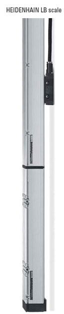

HEIDENHAIN’s longest scale systems are the LBs which utilize a reflective stainless steel tape with a gold graduation (currently 40 µm) as the measuring standard providing a one-piece measuring system with 5 µm /meter accuracy. A series of aluminum extrusions are used to house this tape providing protection from contamination and an accurate mounting surface. Two end caps secure the tape and provide a pre-determined tension factor. The beauty of stainless steel is that it has a similar coefficient of expansion as the machine itself and in many cases the workpiece thus mitigating thermally induced errors.
The LB system is available in standard version and mirror image version (for gantry applications), and with its distance-coded reference marks, a very short traverse will re-establish reference position. Gone are the days of moving long axes to one end of the machine to reestablish home position.
