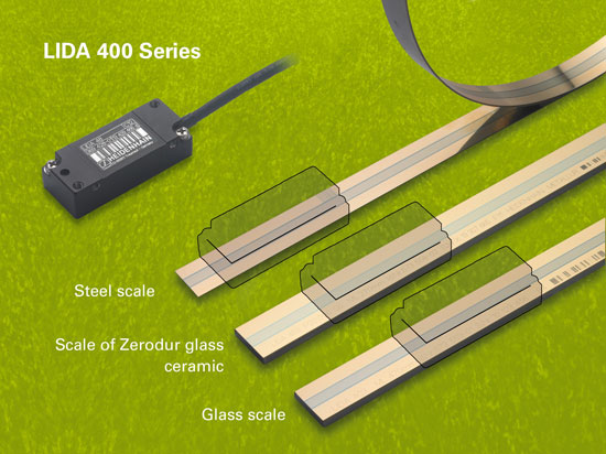

The scanning heads for the LIDA 400 are a standard size, so they meet all requirements for reading the scales of glass and glass ceramic. Also, the identical cross section of the scales allows the graduation carriers to be exchanged.

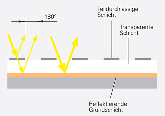

METALLUR process
HEIDENHAIN has developed a process—known as the METALLUR process—for manufacturing graduations on glass, glass ceramic or steel. The quasi-planar graduation structure provides optimum protection against contamination and thereby greatly enhances encoder reliability. The manufacturing processes are environmentally friendly and are entirely without chemicals such as those generally needed for etching.

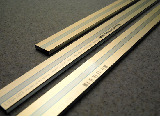

The LIDA 400 exposed incremental encoder from HEIDENHAIN is characterized by high accuracy and customer friendly mounting tolerances, high traversing speed and the small height of the scanning head. These attributes make it well suited for use on production equipment in automation engineering and the electronics industry as well as for applications on linear drives and in many areas of metrology. Now, the introduction of new graduation carriers of glass and glass ceramics (ZERODUR®, ROBAX®) have greatly expanded the range of application covered by these encoders. They are therefore ideal for applications in shop-floor measuring machines. They are very easily installed by the PRECIMET® adhesive film on the back.

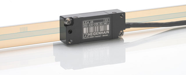

Because the standard scanning heads for the LIDA 400 meet all requirements for reading the scales of glass and glass ceramic (ZERODUR®, ROBAX®), no special scanning heads are needed. Also, the identical cross section of the scales allows the graduation carriers to be exchanged.  From the logistical point of view this is a great advantage because the standard LIDA 48 (1 VPP) und LIDA 47 (TTL) scanning heads can be combined with glass ceramic and glass scales as well as with steel scale tapes. The identical carrier cross section of glass ceramic and glass scales make is easily possible to upgrade existing measuring machines. All designs have the same scanning surface of 14.5 mm², which ensures high tolerance to contamination and generates very clean scanning signals, which can be highly interpolated.
The encoders of HEIDENHAIN’s LIDA 400 series have a grating period of 20 micrometers. They are available in the widely used 1VPP and TTL interfaces and for measuring lengths of up to 30 meters (steel) or 3 meters (glass and glass ceramic). Traversing velocities up to 480 m/min are easily possible. The encoders are available with reference marks as well as integrated magnetic limit switches.
Available measuring standards:
Material      Coefficient of expansion αtherm Max. measuring length ML
  20 µm METALLUR graduation
Glass    ~ 8 x 10-6K-1 3040 mm
ZERODUR® glass ceramic (0±0.1) x 10-6K-1 3040 mm
ROBAX® glass ceramic  ~ 0 x 10-6K-1 1640 mm
Steel   ~ 10 x 10-6K-1   30 040 mm
