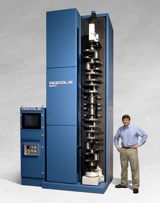

Adcole Model 1200
measuring machine

Currently Adcole is using HEIDENHAIN’s ERA 4280 angle encoder in its ultra-precise rotary table headstock, a key component of its laser interferometer-based Model 1200. Combining sub-arc second rotary measurements with nanometer-level linear measurements allows Adcole’s customers to measure roundness, diameter and other critical parameters on crankshafts and camshafts to accuracies of less then 0.25 microns. “The ERA 4280 has an angle accuracy of ±2.5 arc seconds, which is about 2 to 3 times better than our previous design, and makes it easier for us to calibrate the encoder to a fraction of an arc second,” said Corrado. “It was significantly less expensive to purchase the encoder and read heads as an assembly from HEIDENHAIN than do it ourselves. Plus the ERA 4280 encoder is steel instead of glass, which substantially increases the ruggedness of our design. This is particularly important when loading heavy crankshafts (such as one shown in photo).”
