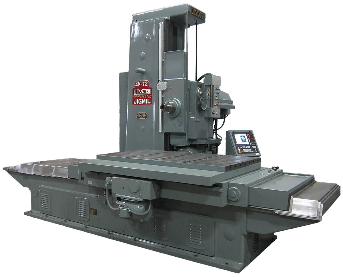

A Michigan machine rebuilder is doing interesting retrofits on old mills using HEIDENHAIN TNCs and scales, enabling them to keep both the mill’s manual features and adding the advanced functions of a control. Advanced Machine Technologies, LLC (AMT) in Owosso, MI has been doing machine retrofits with HEIDENHAIN controls since 1998, and has, for example, recently completed retrofitting a 1974 Devlieg boring mill with a TNC 128 in a unique way.

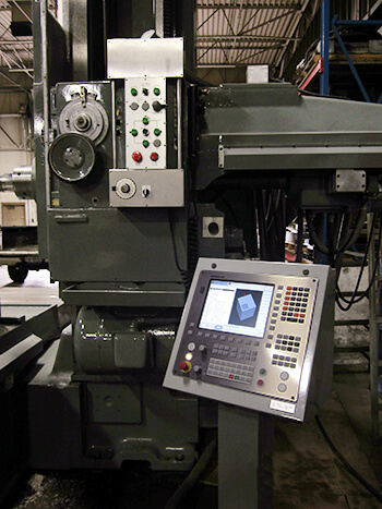

“This machine is a point-to-point mill that came to us in non-running condition with an outdated Anilam control,” explained Lee Horton, owner of AMT. “To update it, we had some mechanical work done, and totally rewired it, put in new motor drive, HEIDENHAIN scales and TNC control. It now is ready to work.
“This particular machine is unique in that normally mills would have a central drive with X and Y axes. Here, we wanted to make use of the Pocket Cycle and Drilling Cycles available on the TNC 128 control, so we opted to put a servo motor on the Z-axis also,” added Horton. “So it actually has two servo motors on it.” Now this old mill has dual function capabilities.
